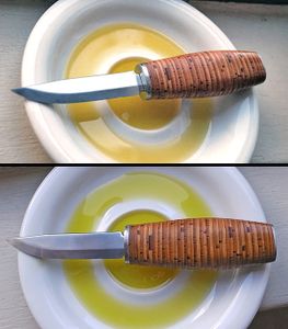

Step 8: Oil and Enjoy Your Finished Traditional Birch Bark Knife!
The last step is the best stage of all for me, it is quite magical to add the oil to the handle and see the beautiful handle take its final form. If you can, heat up the oil and place the knife in a warm or hot place before oiling the handle, it will let the oil absorb more easily into the birch bark, it is not essential though. Let the knife handle absorb the oil for about 15 minutes and then oil it again, until no more oil is being absorbed. Then wipe any excess oil off the handle and blade. Your Birch bark handled knife is now complete!
If your knife blade is carbon steel, you can wipe an extremely light layer of oil onto the blade itself too to protect it against rust. Another option is to create a forced patina by spreading a thin layer of tomato sauce/ketchup onto the blade and leaving it for 30 minutes to an hour. This will considerably darken the metal, but will help protect it against the "bad" orange/red type of rust. I still recommend oiling a carbon steel blade though even if you force a patina like this.
