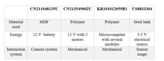

There are 4 patents for products aim for the same purpose as the one this project has which is shown below. A comparison between these patents is done in figure 5. In this project the combination of the ideas of these patents are used. In one of them bird’s arrival gets detected and a calculated measure would be released, and the device would not start again unless the measured amount of food gets finished and the device senses that. In another patent a humidity sensor is used so that during rain, there would be no food distribution.

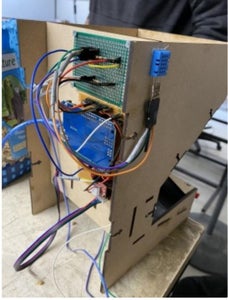

The bird feeder robot can be divide into 2 main sub-system. One is the Mechanical system, the other is the circuitry & sensors sub-system. The circuit board is attached at the back of the Mechanical parts, fixed by screws. The humidity sensor was stuck on the side of food container and the pressure sensor was settled at the pressure sensor adapter. There is an pressure sensor trigger on the sensor. When the foods are given by the valve, the food will be accumulated at the top of the sensor trigger. Thus, the sensor collects the information of the amount of food. When the weight of the food over the setting value, stepper motor will stop giving more foods

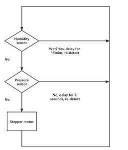

The bird feeder is a machine used for feeding birds in public places automatically, the container and the plate for holding food, when there is no sufficient food inside, the bird feeder is suppose to provide extra food into the plate, meanwhile it should detect the weather condition in case of the food suffering from the rain. Here we considered the basic functions and decided to design it into sensor recognizing, motor control and basic circuit made. The work flow is as follow.

In early work, all the components were tested by order not only to confirm the quality but also to verify the method of application. Here both sensors and stepper motor have been already tested in the bread board with Dupont cables. After that, a base was welded on two separate circuit board, one is for motor control and another one is used for sensor driving.
