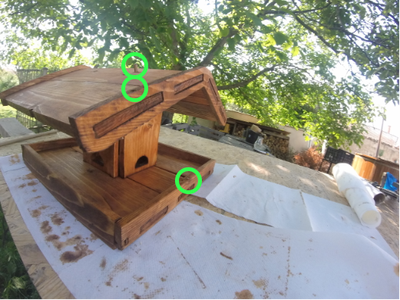

Step 7: Secure Some Joints With 6mm Dowels
At least you have to secure following joints:
- #4 and #5 with #2
- #12 & #15 with #16 & #17
- #13  with #8 & #11
