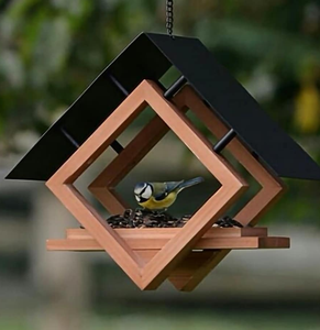

I saw this bird feeder online on a store that displayed as permanent sold out. So I tried to make one by myself.

Step 1: The Sides
The first step was to build the sides. I cut 8 pieces of 20cm long cleat. I cut them with 45° ends each side.
I proceed to glue them two by two to form those kind of V shape. Then, once the glue was dry, I managed to glue two V shaped parts, one with the other. It was a quite long and difficult task. If you have a frame press, I recommend using it.
I added two nail on each side to reinforce those assemblees.
Once done, I glued one triangle piece of wood on each side. Those pieces will be used as supports for the main platform.

Step 3: The Roof
To make the roof shape, I bent a 200mm x 600mm sheet of aluminium in two. In order to have a really nice bent, I used clamps to attach the sheet to a square piece of wood. The point is to have a sharp edge at the exact center of the sheet, where you want the metal to bent. Then, I proceed to press very fermly this assembly against my work table. This way, the sheet is bend with a very clean and tight angle.
I made 8 20mm spacers, using a small aluminium pipe. Those spacers will be used to maintain a fixed distance between the wooden frame and the roof.
If you want to hang this bird house, you can drill a hole in the middle of the bend to attach a chain or a rope directly under the roof.

Step 5: Final Assembly
This is a really precise step. You have to measure exacly where you want to place your spacers and drill corresponding holes in your roof. Take you time, make a drawing ans it will be okay :).
I used a washer to hide the head of my screws a little bit. I think I may not have used the best kind of screw. On the next one, I'll more likely use flat-head screws.
I added a chain with a tiny screw and a bolt to hang my bird house in a tree.
