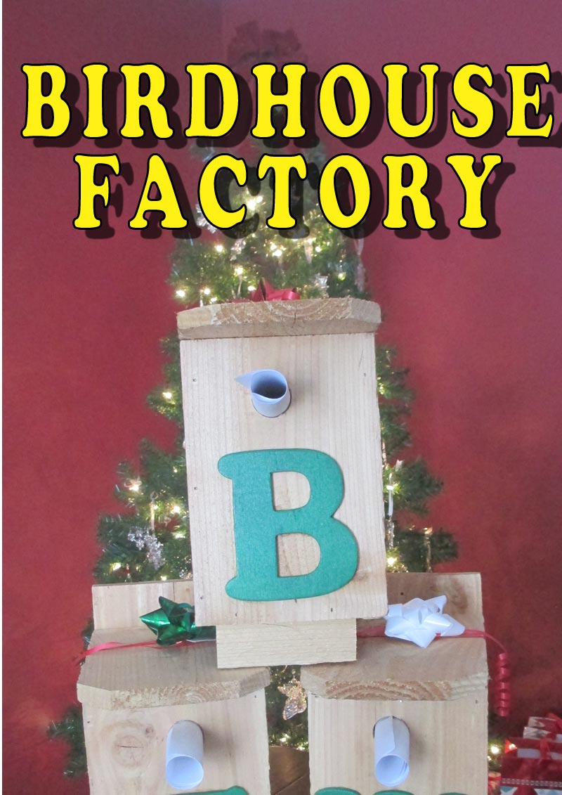

Introduction: Birdhouse Factory for Gift Giving
Please Vote!
This Instructable will show how to mass produce bird houses to give as GIFTS on the CHEAP. Not only will we show how to give as great gift to friends and family without breaking the bank, we will show how to do it relatively QUICK and Efficiently!
The idea is actually pretty simple. How does Santa's Elves manage to mass produce so many great toys and other gifts for the entire World? You must be organized and systematic. In about 4 hours, with help from my son and daughter (the helper Elves), we built 13 Wren Houses for only about $60. That is about a 50-60% savings over paying retail.
Merry Christmas, Happy Kwanzaa, Happy Hanukkah, and all other gift giving celebrations!
