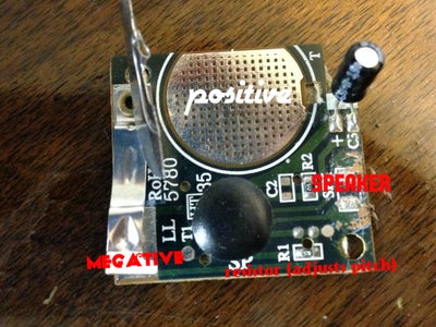

3. The chip - This chip (taken from the birthday card should have abbreviations of which solder point does what (for example: spk stands for speaker). If your chip doesn't have these marks, that's OK, just look at what solder joints are connected to the speaker on the card and use those later. NOTE: THIS PROJECT IS MEANT FOR SOUND CIRCUITS ONLY. IF YOUR BOARD CONTROLS A DANCING FROG AS WELL AS SOUND, THIS PROJECT ISN'T RIGHT FOR IT.

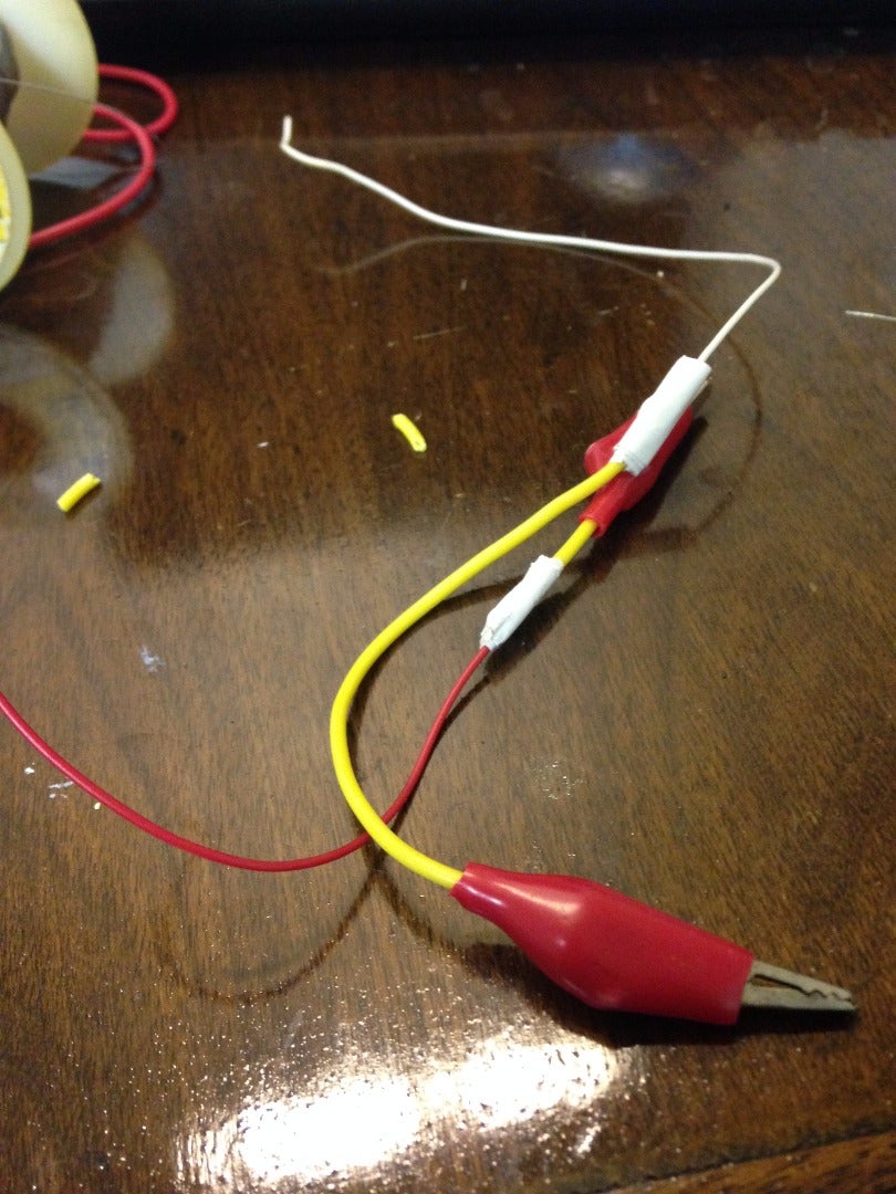

Snap and strip the wires of your Alligator clip and then solder or attach with tape (its much worse than soldering) the wires on. You now have your speaker prepared.

Cut one alligator clip in half. Each of these halves should then be soldered to the battery pack.
It may be helpful if you distinct the two wires, because one will be positive and one will be negative, And your alligator clips might need to be lengthened with wire, as I did.

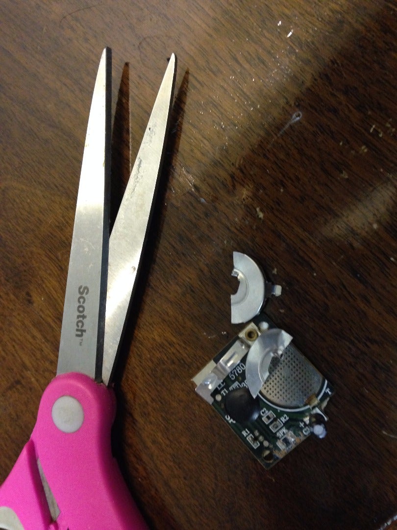

Using scissors or cutters, take off the top of the watch battery holder. take out the battery.
Connect the negative alligator clip to the little metal square under the tab, then connect the positive to the big circle of metal where the battery used to rest. The two wires should be connected to where it says spk on your chip.

If you added a switch push it. Your birthday card should play. When you touch any resistor, your finger will override it. If you touch the resistor between the power, it will make the sound fast, high and squeaky.
