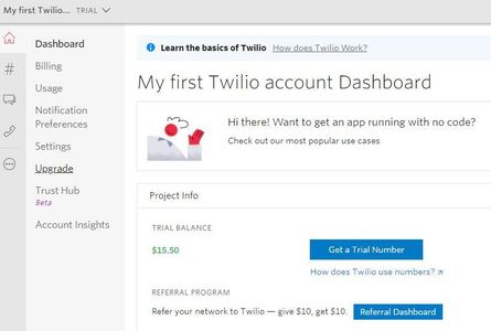

Once you are at your dashboard:
1. Select 'Get Trial Number' - this will be the number that texts your 'verified' phone number
You will need two pieces of information from your dashboard to place in your code:
1. 'Account SID'
2. 'Auth Token'

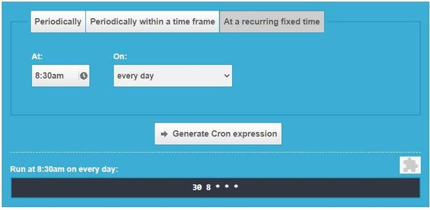

We are going to use CRON to run this script everyday (I run mine every day at 8:30AM).
CRON is extremely awesome for automation / recurring tasks. More info here. You can configure your reminder for whenever and how often you'd like. I really like this scheduler helper.
