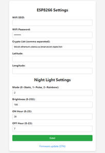

Step 4: Configure BitGlance Via Web Interface
After the code is uploaded and the device reboots, it will start in Wi-Fi access point mode (AP mode) if no Wi-Fi is configured yet.
🔹 1. Connect to the BitGlance hotspot
On your phone or PC, find and connect to a Wi-Fi network called:
SetupAP
🔹 2. Open the configuration page
Once connected, open a browser and go to:
192.168.4.1
You’ll see the BitGlance web interface.
🔹 3. Enter your settings:
  1. Wi-Fi name and password
  2. Cryptocurrencies to display (e.g. BTC, ETH)
  3. Night light mode and brightness
  4. Location for weather (optional)
🔹 4. Save and reboot
Once saved, the device will reboot and connect to your home Wi-Fi. After a few seconds, it will start showing data on the screen!
✅ You can always access the settings again via its IP address on your network.
