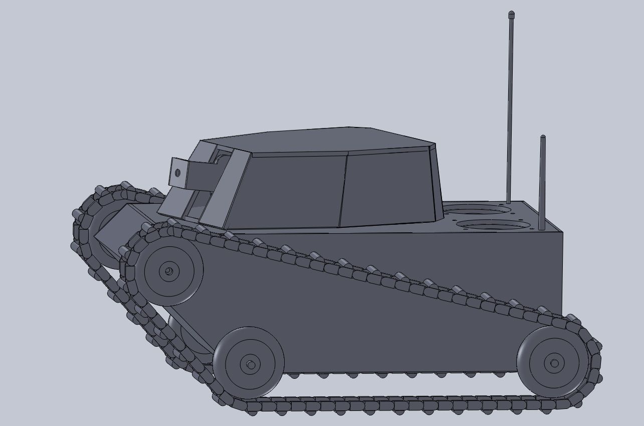

Our first idea was to create a tracked robot able to climb stairs and plenty of others obstacles, to reach a good speed (around 10 or 15 km/h) while filming and transmitting data. It will decide itself if it can go through an obstacle like a slope, stairs or a hole.  Recognizing people and following them, take panorama pictures, follow a GPS designate way are its objectives.
Step 1: Chassis
We made a wooden chassis because wood is cheap and easy to transform. We used 5 mm plywood. This chassis need to be quite big if you want to set batteries, engine and electronics in it and suspensions, wheels and turret at the exterior; there is no maximum size but making it too big can be a problem  for the gravity center of the robot when it climbs stairs.

We used the same plywood for the chassis and the turret, you can do every design you want. The turret rotate with a Servo controlled by an Arduino, we replace the gun by a camera that can go up and down with another Servo. The roof plate is fixed by three screws so we can access easily to the inside, the other plates are pasted.

This phase is relatively short. The turret is fixed to the Servo on the upper plate of the chassis, this place is also equipped with 2 fans, antennas, and 2 handles for an easy access to the inside of the chassis. The suspensions are screwed to the lateral plates (be careful of the tracks length). The tracks are posed on the power wheels; the motors are combined with a gear motor to generate more power.
