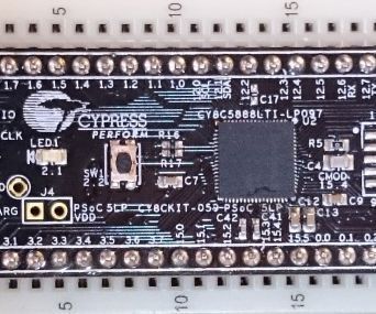

Well if you have ever painted before you probably used masking tape to protect the places you don't want paint, the AND function is great to mask away bits that we are not interested in. like if we have one button connected on a port of our Arduino when we read the port, we get the whole port Byte, but as we are only interested in the one bit we can mask it out by AND'ing it with a mask. Here is an example.
Our port byte = 01101011
and we only want to know if the 4'th bit (bit 3) is '1' or '0' so we do like this:
Button = Port_byte & 00001000
Now Button will be true if the 4'th bit is high, and false if it is low.
