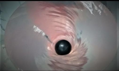

Here we can see that a transparent - plastic container has been attached to the base of the whole setup. On the base is a BO motor and the end of the axis has been attached to a propeller using a small and thin rod. The propeller is inside the plastic container and near the base of the container. The container is filled with water to a certain height. The ping pong ball is placed at the centre of the whirlpool.

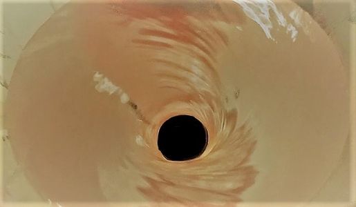

  • Pour water in the container upto a height which is a few centimeters less than the brim of the container.
  • Paint the ping pong ball using black fabric colour.
  • Turn on the BO motor and eventually a vortex will be created.
  • place the ball carefully at the centre of the vortex.
  • You may decorate the model as per your choice
