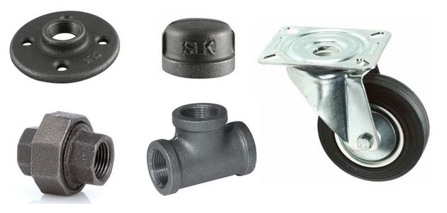

Step 1: Here Are the Materials You’ll Need
  • 1 – 72″ black iron pipe
  • 4 – 36″ black iron pipes
  • 2 – 35″ black iron pipes
  • 2 – 8″ black iron pipes
  • 2 flanges
  • 4 tees
  • 2 end caps
  • 1 union
  • 4 swivel 3″ caster wheels (2 lockable)
  • 2 – 2″ x 10″ x 8′
  • 1 – 2" x 6" x 8'
  • 16 – 2″ round head screws (#12)
  • 8 – 2″ flat head screws (#8)

Step 3: Assemble the Iron Pipes
You’ve probably noticed that the black iron pipes are kinda grimey. The first thing you’ll want to do is take a rag and rub them down vigorously. After wiping them a few times they should be good to go. Nevertheless, just to be safe you might want to avoid hanging any white clothes on the very end of the rack against the pipes.
Because we are dealing with a double garment rack with one pipe across the top and one pipe across the middle, it is important to assemble the pipes in the correct order. Simply hand screw the pieces together by following the diagram shown above.
The tricky part will be assembling the middle horizontal bar. After assembling the outer frame, connect the first 35″ pipe to the middle left tee and the other 35″ pipe to the middle right tee. Insert the union in between to fill the gap. Use two pipe wrenches or tongue and groove pliers to tighten the union until the union and both pipes are snug. It’s a good idea to cover the union with a rag to avoid leaving any marks with the wrenches.
