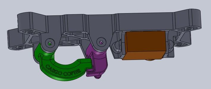

Step 1: Step1: Printing 3D
Print your parts with ABS in medium resolution. The base plate was printed in 0,3mm layers but I recommend making them thinner like the hook parts.
Base Plate volume: 21986.54 cube millimeter
Hook part1 volume: 2557.12 cube millimeter
Hook part2 volume: 3461.60 cube millimeter
The pictures do not show the servo arm and servo rod.

Step 3: Step3: Assembly and Installation
Assemble the hook parts and glue the nail head to the base plate. Install the servo and shape the servo rod accordingly. With double tape, I have attached the landing skid to the base plate and secured it with tie wraps.
Now you have two configuration options: place the base plate so the hook is right under the rotor shaft or turn it around by 180 degrees like shown on the pictures. The base plate is attached to the heli frame with double tape as well and secured with tie wraps.

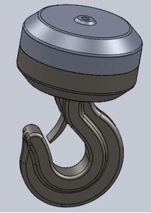

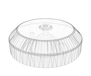

Step 5: UPDATE
I felt I would need a nicer hook so I designed one. Actually the hook is based on the geometry and design of Firebird (http://www.thingiverse.com/thing:14653). So if you like this heli cargo hook, just print the parts from the attached STL files. You don't own a 3D printer? No problem: go to http://www.3dhubs.com/ , register and select a 3D printer in your neighborhood. Pay online and grab it later. Works fantastic.
Note: two parts need to be glued together with acetone. The upper part (grey) will be screwed together. The two cylindrical parts should be printed in the same orientation to match best! The curved hook part should be printed horizontally.
