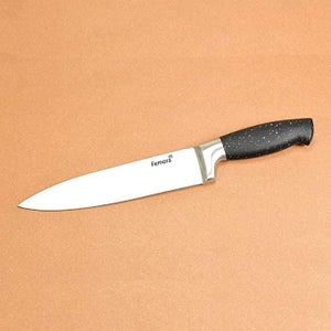

I frequently do projects that require using of various types of blade for various types of applications. such as Xacto blade for making paper craft project. School Knife blade for stripping wire. Knife for cutting fruits and vegetable. Razor blade for stripping paints. A sharp blade can do all the work effortlessly but a dull blade will cause a problem to do the same task. Not knowing how shape the blade is will cause a lot of hassle, time and effort from the work. But when you can compare the sharpness of the bade from a dull blade you know you are in a right direction for completing the task. A blade sharpness tester is not that expensive cost around less than 20 dollar but it is not going to be used all the time for testing the sharpness of blade. Why to even spend 20 dollar when you can build a hack for free with less effort. So I decided to build a blade sharpness tester with the available material in the home. Like a plastic container, some screw, thread and a kitchen weight.
