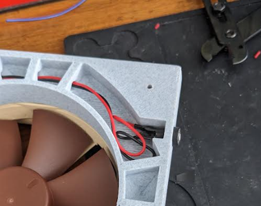

Make sure the fan's airflow is pointing in the correct direction air must be taken from underneath and expelled upwards. Thread the Fan header cable through the lower housing slot
2.3
Fasten the fan down into its position using the screws provided with your fan or some M4 bolts

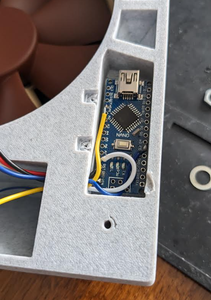

Soldering the Arduino
This process is quiet tedious, the most vital part is ensuring everything is in the correct pin and the solder is not shorting pins.
Wiring pinouts
  • A0 - Yellow Wire
  • 5V - White wire
  • Vin - Red wire
  • GND - Black wire
  • D3 - Blue wire
Gently feed the wires through the hole being cautious to not damage the wires
2.5
Secure the Arduino in its slot by pushing the cage over the top and securing it with some M2*8mm screws, make sure you don't pinch any wires.

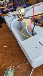

With your potentiometer connect the following Arduino wires to the potentiometer,
  • White wire -> Potentiometer's Vcc,
  • Yellow Wire -> Output pin
  • GND -> GND
For GND you need to also solder an additional black wire, this will go to the buck converter in a later step so keep it long.
Now using the nut and washer mount the potentiometer onto the wall, the small rectangular hole in the wall allows easy alignment with the potentiometer pin.

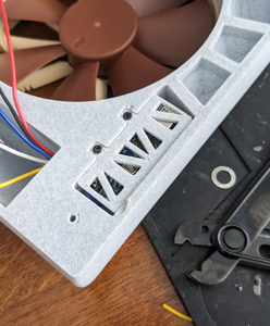

My fan had the blue cable for PWM so I joined it to the PWM signal wire from the Arduino, the PWM cable from your fan may be different depending on your fan so you must look up your fan's datasheet. Solder the two cables to ensure a strong connection and wrap the join in electrical tape to ensure there are no short circuits.

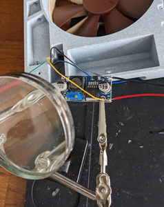

2.8
Wire a red and black wire to the input pins of the buck converter, these will follow the cable management holes to the back of the lower so keep them long. Consulting your datasheet, solder the respective positive and negative fan cables to the same input pads ensuring you have the correct wires since direct 12V across the fan's PWM or tachometer wire will damage or break your fan.
2.9
Solder the Red wire from the Arduino to the positive output pad on the buck converter. Then solder the black wire coming from the potentiometer to the negative terminal on the buck converter. Then screw the buck converter down.

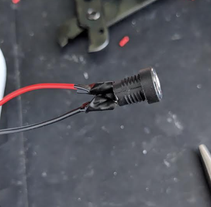

Attach the Jack
First bring the wires out from the hole where the jack will be inserted and solder the jack, the longer pin is the negative so this goes to black.
Wrap the exposed contacts in electrical tape to ensure no short circuits
Now push the jack into the housing, use the included nut to secure it.

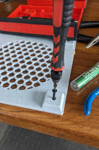

Pre-thread the lid feet with M3*20mm screws.
2.12
Now attach your lid to the underside of the lower housing to hide and protect the electronics

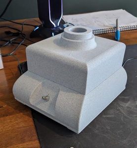

The upper hub can only slot into the bottom one way so simply orientate the upper and friction fit it into the lower.
3.2
Perform a quick test of the device as shown by adjusting the dial. You should get a gradual increase in fan speed as you turn the dial. If the fan seems unresponsive to the dial please refer to the troubleshooting section.
3.3
You may now insert the vent onto the top of the upper it is also friction fit, the vent allows 360 degree rotation for any direction of cooling. You have now completed your fan!
