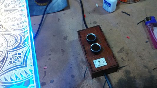

Step 4: Circuit & Control Box
- There are two 12V 5050 LED strips are used to lit both panels of the table. One is blue and another is warm white.
- Intensity of the light can be change varying the voltage supplied to the LED Strips so I added two 1K ohm potentiometers with both strips.
- Negative terminal of LED strips are connected via a switch to the negative of the power supply.
- Power supply, switch and both potentiometers are fixed in a laser cut wired remote control box.
- I also made knobs with the plywood and later fixed mirror like acrylic cut in circle on the potentiometers.
The .ai file for remote control box is attached.
