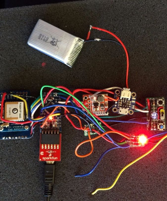

Step 2: Powering the Blimp
I'm using a Sparkfun Powercell LiPo Charger/Booster and a 500mAh LiPo battery to power the blimp.
I connected the Powercell's VCC (voltage out) pin to the Arduino's VIN (voltage input) where it was accessible on the Motor Shield header.
I connected the Powercell's GND (ground) pin to one of the Arduino's ground pins, also where it was accessible on the Motor Shield headers.
