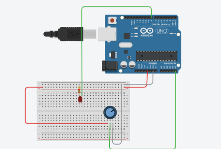

I made a blinking LED where you can adjust that the rate of blinking. My project is based off the Arduino uno blinking example and was made in my Mechatronics class taught by Mr. Sweet.
6 wires, 1 potentiometer ,1 LED, 1 330 ohms resistor, breadboard, arduino uno

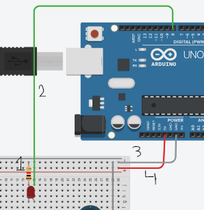

Step 1: Wire Up the LED
Wire 1: First you need to place the led on the bread and then (It's not a wire but,) attach the 330 ohm resistor from the cathode to the negative end of the bread board to help complete the circuit for the led.
Wire 2: Next connect the anode to digital pin 8 so the code will effect the led
Wire 3: Connects the negative end of the bread board to ground on the arduino
Wire 4: Connects the positive end of the bread board to 5v pin on the Arduino. These two wires close the circuit and makes the Arduino able to power the circuit

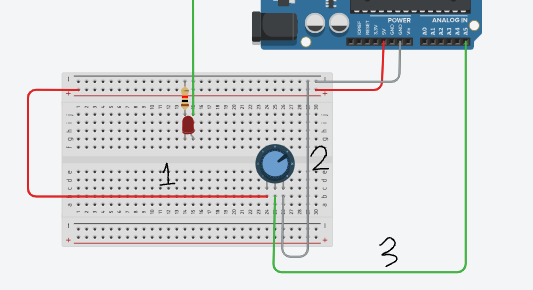

Step 2: Wire Up the Potentiometer
Wire 1: The first wire goes from the left most prong of the potentiometer to the positive end of the bread board, when we code the Arduino this will increase the speed of the flashing light.
Wire 2: The second wire goes from the middle prong of the potentiometer to a digital pin A1, A2, etc..
I choose A5 and this digital pin allows us to read the potentiometer and use it's inputs
Wire 3: The last wire goes from the right most prong and to the negative end of the bread board for a similar function as wire 1

Step 4: Check If Everything Is Wired Correctly
Make sure you check everything before turning it on so u don't ruin the components
