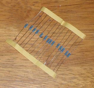

So here is a list of the Materials that I used and where I got them:
Blue Blinking LEDs ( Best HongKong )
Resistors ( Best HongKong )
Copper Metal Foil Tape (Micheal's Arts and Crafts)

After doing some testing with the LEDs that I bought, I figured out that when they blink it actually cuts power from the light itself, so if you were to put a couple LEDs in an array they would blink together and not at there own pace, which would be cool if you wanted that effect, so maybe another project...
So to get the desired look I was going after I need to put each LED on its own circuit persay. So that is each LED needs its own resistor so they will all blink at their own pace.
I used the Copper foil tape as the main circuit for this, and then just soldered the positive leads of the LEDs to one side and the Negative leads to a resistor and then to the other set of copper foil tape.
