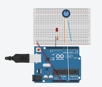

Step 1: Setting Up
  1. connect ground to negative
  2. connect 5v to positive
  3. add an potentiometer on the breadboard
  4. connect the right led of the potentiometer to the negative
  5. connect the middle led of the potentiometer to A0
  6. connect the left led of the potentiometer to positive
  7. add the LED and connect the positive led of the LED to #12 on the ardunio
  8. add a resistor to the negative led connecting the LED to the negative
