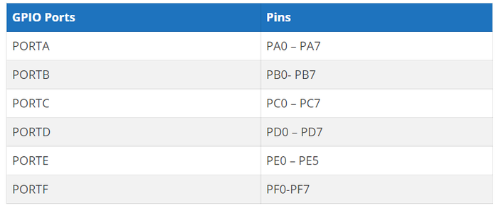

TM4C123GH6PM belongs to the ARM Cortex M4 microcontroller series. It has six GPIO ports such as PORTA, PORTB, PORTC, PORTD, and PORTE. Each port has a different number of pins as given in the above table.

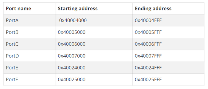

All the address range of port A to port F are given in the table below. As you can see from this table, a total of 4K bytes of memory is allocated for each PORT. The reseason for this larger amount of memory for each port is due to many functions and special functions registers associated with each port of TM4C123G.
