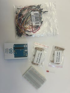

Aurdino:
(Please note all the Aurdino materials came from The Aurdino Uno 3 Ultimate Starter Kit )
  1. Aurdino
  2. Aurdino software
  3. Breadboard
  4. Jumper Wires
  5. Red LED
  6. 330 Ohm Carbon Film Resistor
  7. USB cable to connect the Arduino to your computer

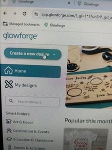

a. Create or Import Your Design:
  1. You can design directly in the Glowforge app or use a design created in external software like Adobe Illustrator, Inkscape, or CorelDRAW.
  2. Designs can be saved in .SVG, .PNG, .JPG, and .PDF formats. Vector files (like .SVG) are ideal for cutting, while raster images (like .PNG) are suitable for engraving.
  3. For this project, I was able to look up the image I wanted on Google and then paste it directly into the glowforge software. Image found here. Then I added a small circle on the nose for the lightbulb.
  4. Tip: Make sure your design is the correct size for your material and that you’re working within the Glowforge bed's dimensions (12" x 20").
b. Upload Your Design to the Glowforge App:
  1. Go to the Glowforge app and click on "Upload" to import your design file.
  2. Once uploaded, you can adjust the design’s position, size, and orientation on the bed.

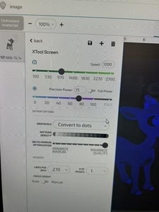

c. Set the Cut/Engrave Settings:
  1. In the Glowforge app, select each part of your design (e.g., cut, engrave, or score). The app will automatically suggest default settings based on the material and type of operation.
  2. Common Settings Adjustments:
  3. Cut: Use high power and slow speed.
  4. Engrave: Use moderate power with a slower speed, depending on the material.
  5. Score: This is a lighter engraving that leaves a visible line but doesn’t cut all the way through.
  6. You can manually adjust the Power and Speed sliders to fine-tune your settings if necessary. Always run a small test cut or engraving first.
  7. I have the settings I used in the photos above.

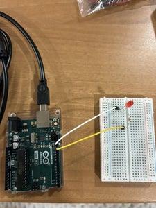

Step 8: How to Use the Arduino
Wiring the LED
  1. Place the LED on the breadboard (optional, but helps keep things neat).
  2. The longer leg (anode) of the LED is the positive (+) side, and the shorter leg (cathode) is the negative (-) side.
  3. Connect the anode (positive leg) of the LED to a digital pin on the Arduino, typically pin 13 for simplicity.
  4. Use a jumper wire to connect the anode to pin 13 (or any other pin if you choose to modify the code later).
  5. Connect the cathode (negative leg) of the LED to one side of the 220Ω resistor.
  6. Connect the other side of the 220Ω resistor to the GND (ground) pin on the Arduino.
  7. This resistor protects the LED from drawing too much current and burning out.
Your LED should now be correctly connected to the Arduino.

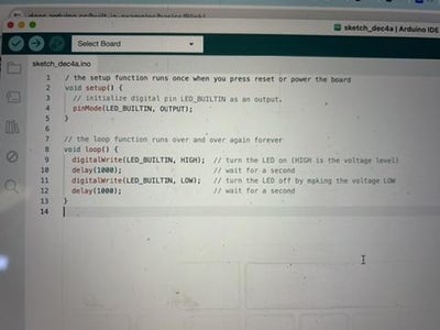

Step 9: Code for LED
Open the Arduino IDE on your computer. If you don't have it, you can download it from the Arduino website as linked above.
Create a new sketch by going to File > New.
Copy and paste the following code into the Arduino IDE:
// Pin connected to the LED
int ledPin = 13; // You can change this if using a different pin
void setup() {
// Set the LED pin as an output
pinMode(ledPin, OUTPUT);
void loop() {
// Turn the LED on
digitalWrite(ledPin, HIGH);
// Wait for 1000 milliseconds (1 second)
delay(1000);
// Turn the LED off
digitalWrite(ledPin, LOW);
delay(1000);
Step 10: Upload and Running Code
Upload the Code to the Arduino
  1. Connect the Arduino to your computer using the USB cable.
  2. Select your Arduino board type (e.g., Arduino Uno) by going to Tools > Board.
  3. Select the correct COM port by going to Tools > Port.
  4. Click the Upload button (the arrow icon in the top left of the Arduino IDE) to send the code to your Arduino board.
Explanation of the Code:
  1. pinMode(ledPin, OUTPUT); sets the specified pin (in this case, pin 13) as an output so it can control the LED.
  2. digitalWrite(ledPin, HIGH); turns the LED on by applying a HIGH voltage (5V).
  3. digitalWrite(ledPin, LOW); turns the LED off by applying a LOW voltage (0V).
  4. delay(1000); pauses the program for 1 second before continuing with the next command.
