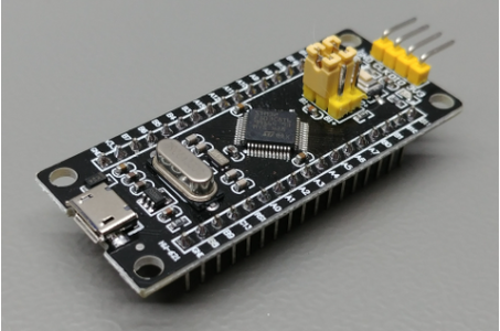

  1. STM 32 BOARD

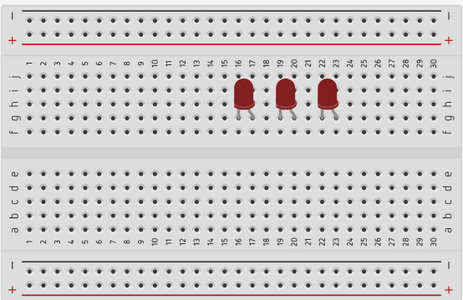

  3. 3 LED's
  4. JUMPER WIRES
  5. BREADBOARD

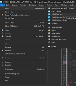

Step 2: STARTING THE PROJECT
As we head into programming in the CUBE IDE head over to the top left and create a new STM32 project by clicking on "FILE" and then "NEW" then after on new "STM32 Project".

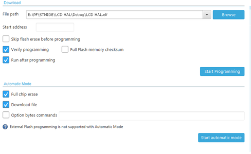

Step 6: Using the Binary File
One of the tricky part is that we will require the binary file i.e. .elf file.

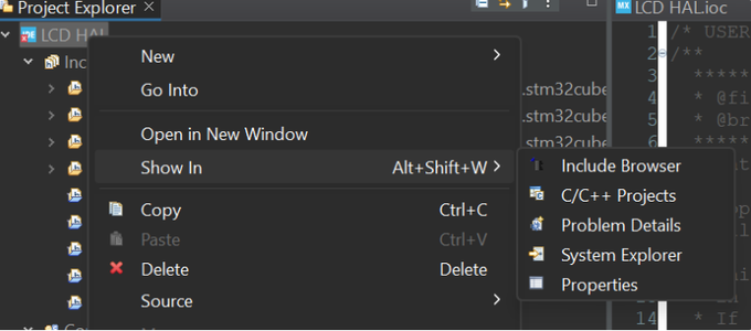

For that, we simply open the .elf file created in the system explorer by Right clicking on the project and clicking on show in system explorer and copying the path on the STM32Cube PROGRAMMER.
Step 7: STM 32 CubeProgrammer
Next we just need to copy the path of the file in the programmer connect the STM32 Board with the system and upload the code to get the required results.
Make sure that hardware implementation is according to the code that we make.
