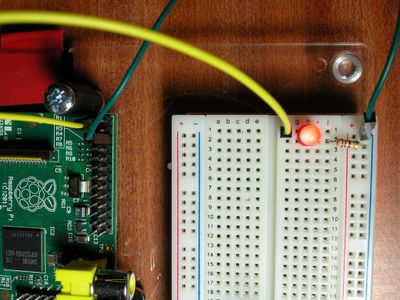

Step 1: Procedure
Here is pin diagram of Raspberry pi 2.
- Connect 11th pin to one end of resistance.
- Connect ground pin to -ev pin of LED.
- Now connect remaining end of resistance to +ev of LED.
- Now turn on Raspberry pi.

Step 3: Finalize
- Save above program as blink.py.
- Now run above program as root user and you will see blinking led.
