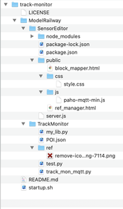

Download all the code onto the Raspberry Pi into the Pi user's home directory into the folders as shown. Note that there is a folder and a shell script. The shell script will start the code each time the computer starts up once the following instructions have been followed and is useful if you wish to change anything and re-run it.
Track Monitor code on GitHub

The code is in
/home/pi/ModelRailway/SensorEditor
Once you have edited the /etc/rc.local file as described above and re-started, the server should be running. On your PC, open a web browser and enter the name "http://raspberrypi.local" or the IP address of the Pi if this does not work (Does not always work on MS-Windows).

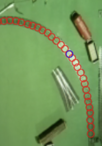

Using the buttons you can add sensors and blocks. Simply press the button of the required one and then move the mouse over the image and click.
If you add a sensor and click a second time it will more. Alternatively you can drag it to reposition.
For blocks, click and keep pressed while you drag the mouse along the path of the track for the entire block.
The above images show the way it may look. Note that as you move the mouse, the system will automatically add more circles to the path - you do not need to keep clicking to add them!
Note too that you can change the size of the sensitive area (the circle shown) - see later for adjustments.

Step 13: Hints When Tuning Sensor Sensitivity
Each sensor and block can have its own sensitivity adjusted to help get a reliable trigger.
Click on the "Monitor Live" button for the sensor and after a few seconds a graph will appear showing samples as they are gathered. The graph updates every few samples and shows a maximum of 1000 giving a few seconds within the graph display.
Adjust the sensor sensitivity value to position it between the active and inactive values as you see them in the graph. Once done, click 'save' and the software will restart and use the new values.
Note that it is possible due to some camera angles that it may not be able to clearly see the track when another locomotive is on a nearer track - in this case just move the sensor position so that it would see the top of the train rather than the track. If you cannot resolve the issue this way, consider repositioning the camera.
