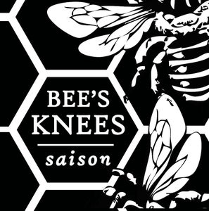

Step 2: Design Your Label
Before designing your label, you'll need to pick the size and shape of the block you want to create. My design is 3 1/4" square. I picked a size that I thought looked good on the bottle, and coincidentally, it also turns out to be the perfect size for making a coaster. Your block, design and paper all need to conform to the shape and size that you select.
Now on to the design part: think simple. Is this your first time carving? Think even simpler. I'd start with text and play around with shapes, spacing and placement until you've got something you like. If you are drawing by hand, fill in your design in ink to get a good idea of what it will look like. The delicacy of pencil is not going to come through in a block printed design- bold gestures and high contrast are your friends.
Because this beer recipe uses honey, I decided on a bee theme. A hexagon grid was the background, and then I fit in text with the name of the beer in one of the cells. Then I added a few bees (along with their knees), cropped the whole thing down to a square, and presto!
