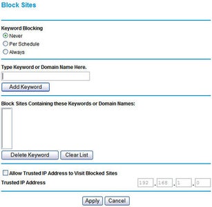

-In the left menu, click on block sites.
*Make sure you have the "Keyword blocking" set to always.
In the blocked sites window, type each one of these websites into the keyword box and click enter. Do them one at a time.
www.atdmt.com
www.doubleclick.net
doubleclick.net
ad.nozonedata.com
ads.pointroll.com
us.ard.yahoo.com
us.a1.yimg.com
us.js2.yimg.com
ad.doubleclick.net
view.atdmt.com
a.tribalfusion.com
ad.ca.doubleclick.net
ads.deviantart.com
pagead2.googlesyndication.com
ad.nozonedata.com
cdn.fastclick.net
cdn5.tribalfusion.com
media.fastclick.net
pixel.quantserve.com
tribalfusion.com
At the bottom of the window, click apply, then in the left window, click logout. Most of the ads are blocked now. The router can not block flash ads though... I am still trying to get it to block them.
