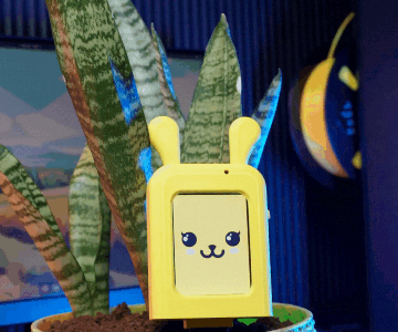

Meet Bloom Buddy - your plant's new best friend! 🌼
Bloom Buddy is an intelligent and interactive soil moisture monitoring device designed to help you care for your plants in a fun and engaging way. Powered by an Unihiker K10 - a ESP32 based Dev Board, this adorable gadget is more than just a sensor. It features a cheerful face, expressive animations, voice feedback, and real-time environmental monitoring.
With a built-in display, speaker, SD card, microphone, and sensors for soil moisture, temperature, humidity, and light, Bloom Buddy provides clear, playful responses to your plant's needs. It celebrates when your plant is well-watered, gets sad when thirsty, sleeps at night, and reacts to temperature changes with unique personalities.
Whether you are a seasoned plant parent or just starting your indoor garden, Bloom Buddy will bring joy and intelligence to your plant care routine. In this Instructable, I will show you how to build your own Bloom Buddy, program its smart behavior, and bring your plants to life with interactive technology.
Let's get started and make your plants feel heard! 🌱✨

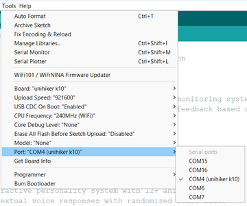

In Arduino IDE, go to Tools > Board and select UNIHIKER K10.
Then go to Tools > Port and choose the correct COM port for your K10 device. If you are unsure, unplug the device, check the available ports, then plug it back in to see which port is newly listed.
