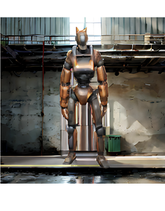

Step 1: The Character Image
To find a good image for Mixamo, I started by thinking about the kind of robot I wanted to animate. I knew I needed something with a clear, full-body view and a neutral pose—something that would translate well into a 3D model. I focused on finding a front-facing image where the robot was standing upright, with its arms and legs visible and spaced naturally, like in a relaxed T-pose or A-pose. This helps later when Mixamo tries to place the joints during the rigging process.
I also made sure the robot's design was clean and easy to read. I avoided images with overly complex backgrounds or cluttered details, which can make it harder to define the shape when converting to 3D. I explored different sources and options, including drawing tools and image generators, until I landed on a design I liked—a bold orange humanoid robot. The color made it visually striking, and the humanoid shape made it perfect for applying standard animations in Mixamo.
Step 2: Preparing for 3D Rendering
After choosing the orange humanoid robot image, the next step in my process was to remove the background to prepare it for creating a 3D model in Meshy. I used remove.bg, a free online tool that quickly removes backgrounds from images. I uploaded my robot image to the site, and it automatically detected the robot and erased everything else. Within a few seconds, I had a clean version of the image with just the robot on a transparent background. This was important because Meshy needs a clear and unobstructed subject to accurately generate a 3D model. With the background removed and the robot clearly isolated, I downloaded the transparent PNG and got ready to bring it into Meshy for the next step in the process.
Step 3: Creating the 3D Model
Once I had the transparent PNG of my orange humanoid robot, I moved on to importing it into Meshy to start the 3D generation process. On the Meshy website, I selected the "Image to 3D" feature and uploaded my cleaned-up robot image. Meshy processed the image and generated four low-resolution, untextured 3D draft models, each with slightly different interpretations of the robot's shape and proportions.
These initial drafts gave me a chance to compare variations and choose the one that looked the closest to what I had in mind. While the drafts were rough and didn’t include any colors or textures, they gave a good idea of the overall form and structure. After reviewing them, I picked the version that best captured the look and posture of my robot. I then clicked confirm to enhance and texture the model, and Meshy started refining it—adding surface detail, color based on the original image, and making it look more complete and polished. This upgraded version would be the one I’d eventually rig and animate in Mixamo.
Step 4: Downloading the Model
After Meshy finished generating the textured 3D model of my robot, I was ready to export it so I could use it in Mixamo. On the Meshy interface, I clicked the "Download" button, which opened up a few file format options for exporting the model. From the list, I chose FBX, since that’s one of the formats Mixamo accepts for auto-rigging and animation. Clicking FBX started the download of my fully textured 3D robot model as an .fbx file, which I could now import directly into Mixamo for the next stage of the process.

Step 10: Importing the Robot
With the default cube deleted and a clean Blender scene ready, I moved on to importing my animated robot. I went to the top-left corner of the screen, clicked on File > Import > FBX, and navigated to the location where I had saved the FBX file from Mixamo. This file already included the robot mesh, skeleton, and the Catwalk Sequence 2 animation.
I selected the file and clicked Import FBX. After a moment, the robot appeared in my scene, fully rigged and posed in its first animation frame. I scrubbed through the timeline at the bottom of the screen to confirm that the animation was working properly—and sure enough, the robot smoothly walked through the catwalk motion, just as it had in Mixamo. Now the character was fully in Blender and ready to be placed in an environment, alongside the other assets I had gathered.
Step 11: Importing the Warehouse
Since the warehouse model came from CGTrader and was in FBX format, I followed the same steps to bring it into Blender. I clicked File > Import > FBX (.fbx), then navigated to the folder where I had saved the warehouse file from CGTrader. After selecting the file, I clicked "Import FBX" and Blender brought it into the scene.
The warehouse appeared at the center of the workspace. I used G to move it into place, S to scale it if it came in too big or too small, and R to rotate it as needed. Once it was properly positioned, I had a full environment set up for my robot animation to take place in. With both the animated robot and the CGTrader warehouse model in the same scene, things were really starting to come together visually.
Step 12: Lighting
After importing the warehouse model, I used Blender’s standard lights—like the default point light, sun, and area light—to light the scene. I didn’t add anything complex; I just focused on positioning and adjusting these basic lights to get the look I wanted.
Lighting turned out to be a crucial part of the scene. It helped define the robot’s shape, cast realistic shadows, and gave depth to the warehouse environment. By carefully adjusting the strength, angle, and placement of each light, I was able to highlight the robot’s movement and make the space feel more believable. Even with just the standard lights, I could shape the mood and ensure that the most important parts of the scene were clear and visually engaging.
