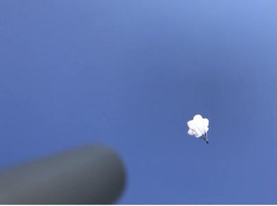

Step 8: Load the Blow Gun
Take the circumference of the canopy and wrap it around the plastic tubes. Twist the tip a bit more to reduce the diameter of the parachute. Carefully insert the parachute into the PVC pipe. It should slide easily without binding.
Push in the shroud lines (tubes) followed by the paratrooper and push the nut-end into the tube as far as you can with your finger.
You are now ready to launch!
Step 9: Launch Your Paratrooper
Find an open area with little wind.
Take your preloaded blow gun and aim toward the sky.
Give a hard puff of air to launch your paratrooper skyward.
Watch him float back to earth.
Retrieve and Repeat.... Retrieve and Repeat... Retrieve and Repeat (You get the idea).
Enjoy and have fun!
An encore presentation of the slo-mo:
Note that the slo-mo can be a bit deceiving. The parachute probably went about 15 feet high and fell quickly to the ground. (It occured to me I should try it without the steel nut for possibly longer hang time.)
Lower height and quick turnaround time makes this paratrooper ideal for small yards and small children, and you can safely launch in a breeze.
