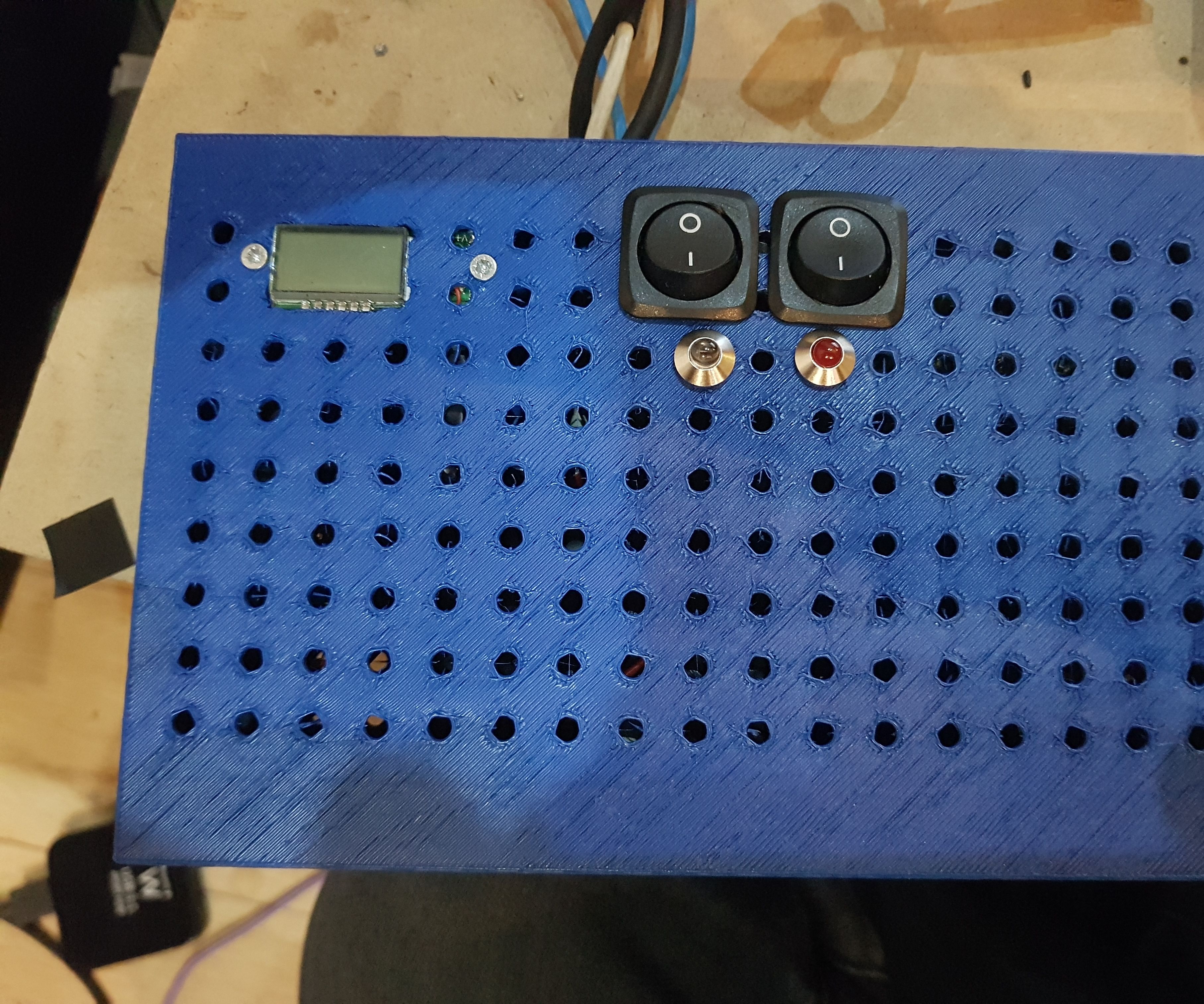

on the picture you can see the 10 vertical beam and the 2 custom horizontal: 1 for the picoprojector and 1 for the cam at the front at the back we have a box to put some mess on the cover it s my keyboard older I found it on internet, on the top of the box there is the powerbox to turn on off the robot and the raspberry the batery level display

I made some level between the different card to have something more clear
the second picture represent my sound system old broken beats speaker I baught a 5v amplifer and a filtrer
and the last one is my top back left robot covering with usb hdmi and ethernet port
