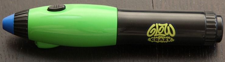

Step 1: Take the LASER Pen...
Remove the screws from the pen and prize open with a flat object.

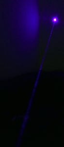

Step 4: Make the Pointer
There are many ways to mount this so I won't go into that.
I decided to keep the existing lens as it focuses nicely once removed from the casing.
I leveled off the plastic around the bottom of the laser module, applied some Arctic Silver thermal compound and attached it to a PC heat sink.
I used a 3.7volt 1800Ma cell from an old laptop battery to power the driver board that I reconnected to the LASER with wires.
Happy Modding!
