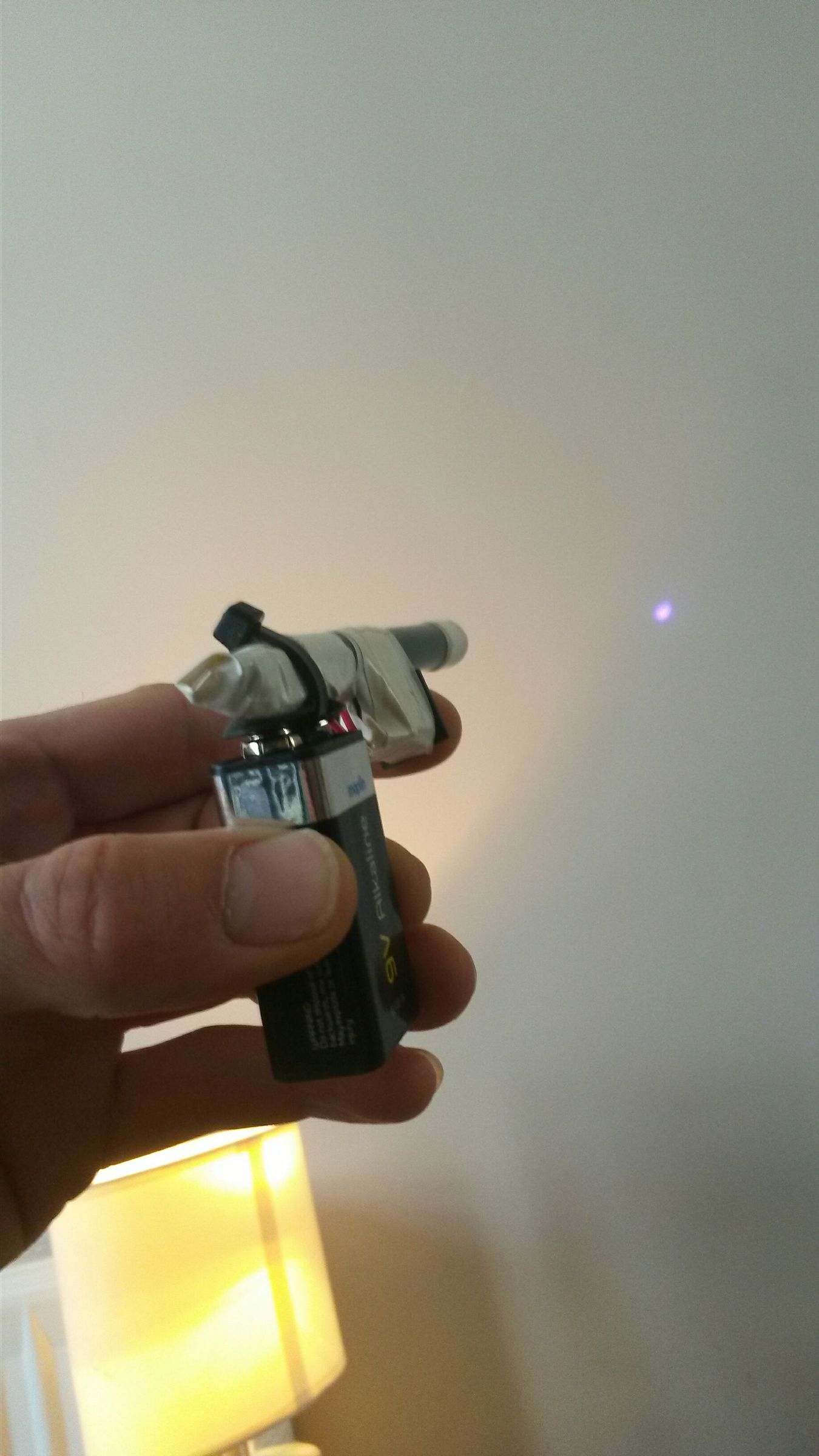

Step 4: Wiring the Blu-Ray Diode...
This takes extreme care and caution as well as a steady hand and a nice pair of strong reading glasses or magnifying glasses. With quick touches of your soldering iron and using a solder sucker, remove the solder from the small board and remove the small board, You should end up with the raw laser diode. Following the diagram, solder two wires. One to the ground (top pin) and another to the laser diode (far left pin as you are looking at the back of the diode).
Step 5: Finish the Blu-Ray...
You will want to gently install the Blu-Ray diode im the Aixiz laser housing by using a small pair of pliers or vice-grips. NOTE: The wiring to the 9 volt battery clip should be done after you have run the wires to the battery compartment. You will understand when you look at it. The diode should fit flush to the housing. Then, solder the Negative (-) wire to the switch and a wire from the other leg of the switch to the black wire on the 9 volt clip. Then solder the Positive (+) wire from the diode to one end of the Resistor and solder the red wire from the 9 volt clip to the other end of the resistor. Hot glue or epoxy (I use hot glue so if I ever want to remove the Blu-Ray, it's an easy task) the Aixiz housing to the original lightbulb mount.
