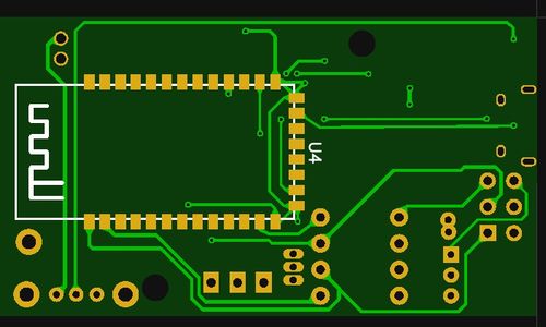

Step 3: THE BOARD
The board that I designed for this Instructable can be ordered from JLCPCB or some other site such as Seedstudio ect if you use the gerber files attached to this Instructable. I designed it using easyeda.com. Here is a link to the board at easyeda. https://easyeda.com/MrFixIt87/mitutoyo-bluematic-spc-smt-mcp73831 If there is enough interest, I may have a few PCBs made and sell them cheap on ebay.
This board must be cut into two separate boards (one for the transmitter and one for the receiver). The cuts will follow the white outlines at the center of the PCB in the image above and one corner of the transmitter board. These cuts will follow the red lines drawn on the picture of the PCB above. Be careful when cutting the boards, particularly in the notches at the corners of the transmitter board. These cuts get very close to traces on the board. A set of fine files comes in handy here.
Most of the components can be ordered from Digi-Key or Mouser etc, Digi-Key part numbers are included in the BOM for items that they have. Some of the items I bought on eBay, Amazon or AliExpress. I have included links to items on those sites as needed in the BOM.
The BOM.pdf file is the easiest to read and the URLs are clickable links.
