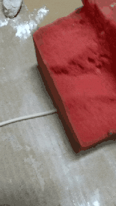

Step 6: Rolling Clay Thread
Layout out old cardboard sheet, Apply talc powder and rolling out the clay, initially roll it out with your fingers and inorder to make it even use sponge and roll, it evens out as well gives nice texture.

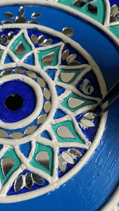

Step 16: Mirror Position & Style
Keep and see the position and pattern which works out for you, as an artist go with your intuition on this part. I have decided and worked based pattern and design which suited most apt for the shapes drawn here
Step 17: Stage 1
Keep the leaf shape(7mm length) in blue circle, For Aqua petals drop mirror cut placed one each as the space resemble a gap of drop shape.
Step 18: Mini Lotus
For Ultramarine space, place three leaf shape mirror as it brings out blooming look.
Step 19: Stage 2
For Blue circle space giving a semi flower like pattern by keeping 10mm circle and giving out leaf shape mirrors as petals to flower. 12 mirror flower can be given if keep the small flower edges as mark point.
Step 20: Big Flower Petal
For this randomly kept a design of 3 drop(10mm) and 1 circle (10mm)
Step 21: Ultramarine Space 2
So far all design have been given in symmetrical pattern, so decided to go here with alternate pattern 6 space full flower design with Rhombus petals and square checker at placed at 45 degree in remaining six space
