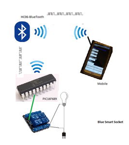

Step 1: Required Theory Concepts
PIC16689 microcontroller has a built in USART hardware that
allows to communicate with a wide range of serial devices such as Bluetooth, memory chips, LCDs, personal computers, etc.
USART uses serial communication. In Serial Transmission only one bit of a byte is transmitted at a time. There is only one communication line, thorough which bits are transmitted sequentially. The key challenge in a serial data link is to maintain the synchronization between the transmitter and the receiver. The asynchronous method uses a start and stop bit protocol to synchronize the two ends. Each character byte is sent in a frame consisting of a start bit , followed by the character bits, followed (optionally) by a parity bit, and finalized by one or more stop bits. The sender and receiver have to be initialized to use the same data rate, number of data bits, and number of stop bits.
As shown in above diagram, once the communication channel is made between Smart Phone and Bluetooth device(Paired), Smartphone can send data to the Bluetooth device through serial wireless communication. Bluetooth will communicate with PIC16f689 microchip with microcontroller USAT hardware and program the microchip act according to the data.
*ref http://embedded-lab.com/
