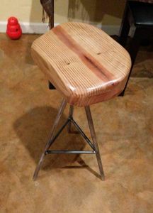

I started with a couple 2x10 cutoffs from my Red Bench project. I glued them together to double the thickness, then drew a bar stool seat shape and cut it out with my band saw.
I'd seen this technique before and wanted to try it myself. I used a rough grit flap disc on my angle grinder to carve the contours of the seat.
Step 2: Finishing the Seat
To darken it, I applied a coat of Steel Wool and Vinegar stain. To seal it, I applied several thin layers of spar urethane, making sure to lightly sand with 400 grit between coats.

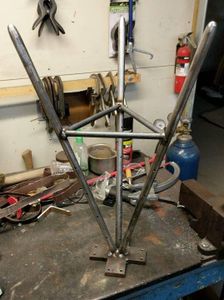

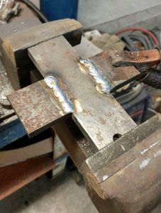

I wanted to try welding legs and a base for my seat, so I visited my parents so I could pick my dad's brain and use his welder. After practicing on a scrap piece of steel for a while, I welded this base.
Step 4: Legs

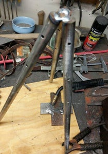

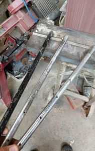

The legs were made out of these steel spikes he had laying around. I believe they are used for pouring concrete foundations. I used a belt sander to round over the point, and remove the black paint.
I used a piece of plywood and what little high school geometry I've retained to make a jig to evenly space the legs, before tacking them together at the top.
I welded them to the base plate, then used 1/2" round stock to add stretchers between the legs.

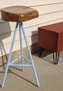

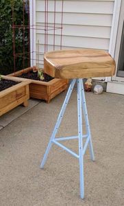

After cleaning up the legs with a flap disc and removing any oils with rubbing alcohol, I spray painted them. I kept adding thin coats until I had used up the whole can.
Step 6:
I screwed the legs to the seat and we were done!
Over time I've started to have issues with the layers of the seat separating. I had hoped the spar urethane would protect it from changes in humidity, but it didn't. If I were keeping it inside, it'd probably be fine. I ended up zipping in some screws from the bottom of the seat, and that seems to have kept it from getting any worse.
