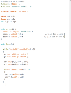

Download the code and upload it on your ESP32 using the Arduino IDE (make sure to have the right drivers and add the board to the board manager, use a nice USB cable to upload the code as i had some issues). Please check the code, you can change the Bluetooth device name and change the servos ports and adjust them.

Then I made the block coding. First enabled the accelerometer sensor when the screen is initialized, Then added the bluetooth devices to the listpicker. When bluetooth device is selected (listpicker element), call bluetooth client and connect it to the selected device. When bluetooth is connected Then change a text to connected and its color to green. When the acceleration change set x and y values to two labels multipliying by 10.
We will send the data vía bluetooth using the timer of the clock, this is really important as I could not get this to work properly couse I sent the data when acceleration changed. You can set the timerinterval (the minimum is 30 ms). I decide to add 100 to the values, so I receive only positive values on my esp32.
