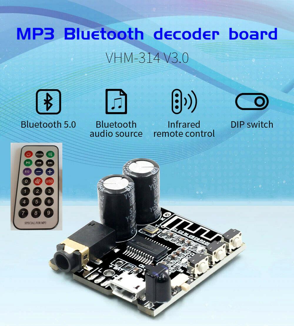

I originally ordered the DF Player used in the youtube project and a small amplifier module, I then discovered the Bluetooth modules which were available and decided this may be an easier option as it would be possible to stream direct from a phone rather than having to load an SD card with music.
Unfortunately the easier option of ready made complete Bluetooth units, which were generally for use in cars and other projects, were all too large for the case I had chosen for my project so I had to settle for a small module and add the controls separately. Because the case was small it also limited the size of the speakers that I could use and potentially the sound quality and output.
I ordered a VHM314-3.0 Bluetooth module which I thought would do the job, however the module I received was somewhat different to that which I had ordered. I spent some time trying to find information on this different module, without much success, but it did seem to be similar, if not visually the same, as the VHM314-3.0 module. I eventually found a supplier on Aliexpress who was selling this module, but unfortunately not much information given on the site.
There was one notable difference with this module in that it had a Micro SD card slot I assumed for MP3 music files, which did turn out to be the case and was a bonus.
Whilst playing with the module I discovered that it also had an FM radio built in so again another bonus but it did mean that an aerial was now required which meant some alteration to the original case design.
The Bluetooth module had built in battery charging provision which I thought would simplify construction, however this turned out not to be the case and it would have been better to have a separate battery charging module. The output from the voltage regulator of the Bluetooth module seems to be barely adequate for the module let alone for anything else. This made it more difficult and led to other annoying minor problems that were not so easy to address.
