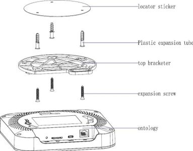

Step 2: Install AoA Locator to Your Ceiling Roof
After knowing what is BLE AoA technology and its deployment modes, you can start to implment it.
  1. Choose a good location on the ceiling, check the network cable and power supply port locations, and then place positioning stickers. Operators must be mindful of their own personal safety when implementing.
  2. Drill holes in the locations indicated on the positioning sticker by using an appropriate electric drill bit based on the size of the plastic expansion tube.
  3. Put the clear expansion tube into the gap created in step 2 of the process. The wall and expansion tube must both be level.
  4. Align the top holder's fixing hole with the enlarged plastic tube and secure it using expansion screws one at a time. The top bracket is then securely fastened to the wall. Remember that network and power supply cables can be fastened to the bracket first through the wire hole, allowing them to be gathered in the bracket. Directly attach the ceiling bracket if necessary.
  5. Sequentially install the locator ontology interface and insert relevant components.
  6. Ontology-specific grooves, followed by lifting the ontology vertically and horizontally close to the suction top bracket while positioning the post in the relevant slot.
  7. Slightly reposition the ontology so that the three bracket hooks can fit into their proper ontology positions. The bracket and ontology are now flush. Rotate in the direction of ontology's shear head. The AoA locator installation is finished when you hear a sound.
  8. The final stage is to carefully inspect the product to ensure that it has been placed correctly, that everything is smooth, that there are no evident shaking issues, to clear the cable and power cable, and to hide as much as possible because one cannot simply become nude.
The complete installation steps and sketch map can be found here:

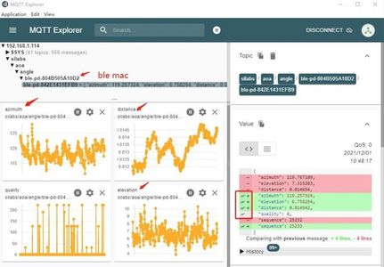

Step 3: Configure AoA Locator and Get Data
  1. Enter the genuine IP address of the gateway from the router to log in. The AOA locating gateway's general status was then provided to us.
  2. Go to IOT Services -> Locator in the setup page. The gateway itself serves as the default MQTT server for posting data, and the server address and port credentials are changeable.
  3. Install the MQTT Explorer by downloading it. Enter the gateway's IP address and port in the MQTT Explorer.
  4. When you click "CONNECT" and turn on the AOA tag that was placed close to the locator, the position information will appear like the image I uploaded.
Reminder: this is the way to configure a single AoA locator. If you want to configure multiple AoA locators, feel free to contact Dusun IoT.

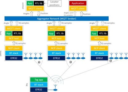

Step 4: Port Engine Position
Real-Time Locating library (RTL lib) from Silicon Labs processes IQ samples obtained from the Bluetooth stack, employs multipath detection, and calculates azimuth and elevation before making the data available to the application via an open API.
If the library is aware of the positions of each locator, it may also use triangulation in a multi-locator scenario where many locators are receiving CTEs from the same asset tag to estimate the location of a tracked object.
In this instance, the estimated location is the output, while the locators' positions and estimated angles (AoA) are the inputs. The user's application determines how to handle the data after the positions are estimated. The graphic I submitted depicts the general architecture of an RTLS utilizing the Silicon Labs RTL library.
