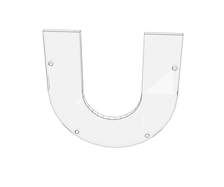

Step 6: Design the Case!
Of course you can use my stl files; I decide to use a horseshoe formfactor, so it can fit around the handlebar. I added a batterycase at the bottom, which can be easily detached.
