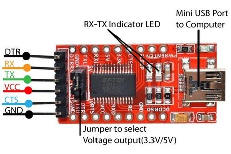

11- FTDI or USB to TTL to program the microcontroller

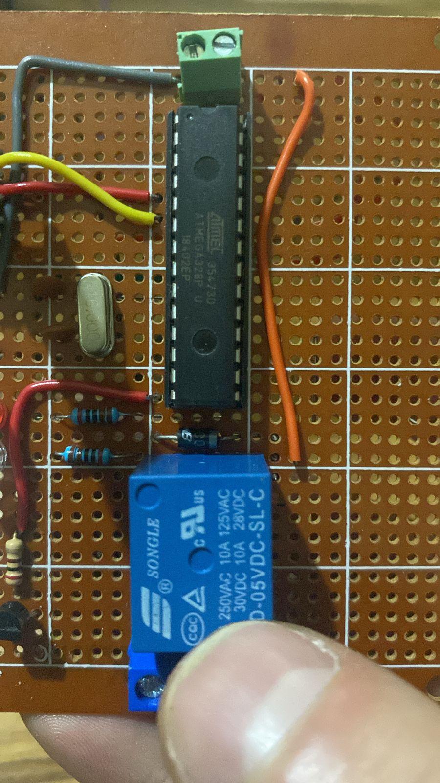

Step 1: Testing the Code and Board Using Arduino
The first step in unleashing the potential of my DIY Bluetooth board is to test its code and functionality. To kickstart the process, I'm setting up a test environment using a breadboard and Arduino. This ensures a smooth debugging process and lays the foundation for seamless integration into future projects.

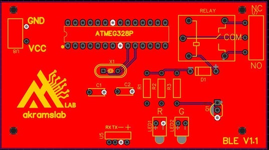

Step 2: Board Creation: Transitioning From Prototype to PCB
Now that the testing phase has proven successful, it's time to elevate our DIY Bluetooth board from prototype to a more permanent form. Utilizing printed circuit board (PCB) technology, we'll design a compact and efficient layout for our components. Incorporating transistors and diodes, we enhance the board's capabilities, ensuring reliable performance and power management. With steady hands and precision soldering techniques, we'll bring our design to life, soldering each component onto the PCB. This marks a significant milestone in our project journey, transforming our idea into a tangible reality ready to be integrated into various applications.

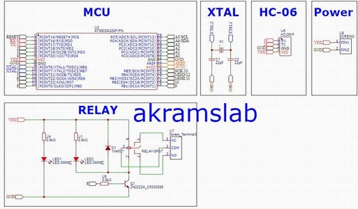

Step 4: Design Refinement: Transforming Prototype Into Production-Ready Circuit
Now that our DIY Bluetooth board has passed rigorous testing, it's time to refine our prototype into a production-ready circuit. In this step, we'll leverage EasyEDA to meticulously design a professional-grade circuit layout. EasyEDA's intuitive interface allows us to seamlessly translate our prototype into a digital blueprint, ensuring precise component placement and optimized routing. By fine-tuning our design, we can enhance functionality, minimize footprint, and streamline manufacturing processes. This critical phase brings us one step closer to realizing our vision of a market-ready product.
