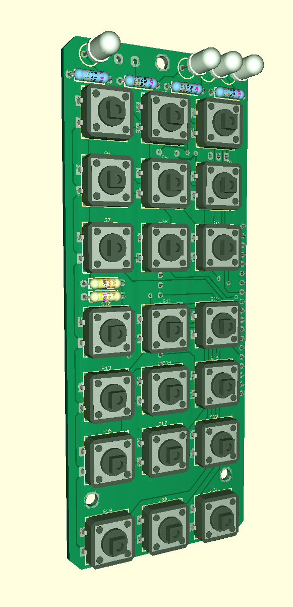

The brain of the remote control is a ESP32 microcontroller on a custom designed circuit board.

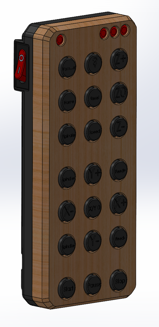

For the housing of the remote, I decided to make use of both my 3D printer as well as the CNC itself. The more complex part with the battery holder, mount for the charging board and cutouts for USB charging and the on/off switch is 3D printed. The front part is CNC machined out of a 10mm piece of wood I had lying around.
I Included all the 3D models (3D printed back, CNC machined wooden front, PCB, Buttons etc) as a step file. This way it is up to you, wether you want to directly convert them into STL-files for 3D printing etc. or modify the parts to your liking.

Step 1: PCB Design
This was one of the first PCBs I ever designed and I made lots of mistakes in the design process. The attached schematic slightly varies from the PCB you will see throughout this instructable. I fixed some mistakes I made in the original design (see step 3)
The remote has a total of 21 individually programmable buttons. A red LED indicates if the remote is turned on and if there is a bluetooth connection, while the other three LEDs show different speed modes for jogging the machine.
Step 2: Designing the Housing
Once the PCB Layout was finished, I started 3D modeling the housing for the remote control.
To build the housing, I decided to make use of both my 3D printer as well as the CNC itself. The more complex part with battery holder, mount for the charging board and cutouts for USB charging and the on/off switch is FDM 3D printed. The front part is CNC machined out of a 10mm piece of wood I had lying around.
Step 3: Assembling the PCB
As mentioned previously, I made many mistakes with the PCB design.
I soon realised that I forgot to connect all 4 LEDs to ground and some of the buttons required additional external pull-up resistors to work properly. Also one of the switches had to be wired up to another pin. While this looks really messy, everything seemed to be working.
Another problem was the use of THT components instead of SMD compontents. While this helps with the proper alignment of the buttons, this also meant that there would be pins sticking out on both sides of the PCB. Some masking tape to protect the PCB and a file solved this issue.
Placing the voltage regulator next to the antenna of the ESP also was an issue and I am certain the bluetooth connection would be better with an improved layout. Speaking of the voltage regulator, I should have used a low dropout voltage regulator, since the regulator I use struggles to create stable 3.3V for the ESP once the battery drops below 3.8V.
Nevertheless I got the hardware working and could continue assembling the remote control.
___________
I made some changes to the PCB design and fixed all the problems I am aware of. I added missing Pull-Up resistors, connected all LEDs to ground, connected one of the buttons to another pin and switched to a LDO voltage regulator, which should work better with the output voltage of the battery. I also relocated the voltage regulator and capacitor, so they should not interfere with / block the antenna of the ESP32 anymore. I have not actually tested this version of the boards. So use at your own risk! But I think all the problems should be fixed and hopefully there are no new problems that I am unaware of.
Step 4: Machined Front Piece
I tried to keep the front piece of the remote control as simple as possible so It could be machined from a single side. Only some cutouts for the buttons, LEDs and marking where I would screw into the front.
