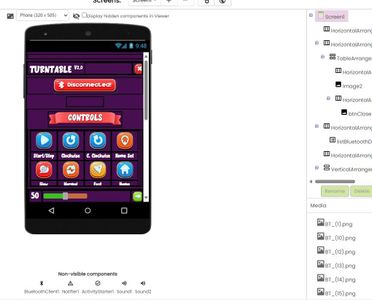

The mobile app was programmed using the MIT App Inventor Android app builder tool. The app has a main screen that controls all of the turntable's functions, including Bluetooth connectivity, basic rotation controls (start/stop, direction, and speed), manual snapping, and an auto-snapping feature that triggers the camera at selectable segments of a full turn.

Step 4: The Code
I programmed the Arduino Nano to control the stepper motor and functions of a motorized turntable via Bluetooth commands. With limited programming skills, I used ChatGPT to improve the code.
The Arduino code handles several important features:
  1. Start and stop the motor.
  2. Change rotation direction (clockwise/counterclockwise).
  3. Adjust the motor speed dynamically.
  4. Rotate a specific fraction of a full turn (e.g., 1/64, 1/48, 1/32, etc.).
  5. Manually trigger the relay at any time via a button in the app.
  6. Rotate in increments while automatically triggering the relay (used for controlling a DSLR or mobile camera).
The Bluetooth communication is managed using a SoftwareSerial connection between the Arduino Nano and the HC-05 Bluetooth module.
Incoming commands from the mobile app are interpreted by the Arduino, which then executes the corresponding motor or relay actions.
The stepper motor is controlled via a TMC2209 stepper driver, ensuring smooth and quiet motion even at different speeds.
For Smartphone camera triggering, the Arduino Pro Micro requires a small code that simulates the volume-up button while the camera app is running, as pressing the volume-up button on most smartphones triggers the camera to take a photo.

Step 5: Mobile App Making
For this project, I used MIT App Inventor, a user-friendly platform that allows you to build Android apps using a drag-and-drop interface. The great thing about App Inventor is that it doesn't require advanced programming skills, like mine.
So yes, the app works only on Android devices.
I designed the app to control the turntable, as explained in the previous steps.
The app’s interface is simple. It includes buttons for each command (start/stop, speed control, direction change) and a slider for adjusting motor speed. Additionally, I incorporated Bluetooth connection functionality to allow communication between the mobile device and the Arduino Nano via the HC-05 Bluetooth module.
The (Home & Set Home) buttons are inactive at the moment and will be activated in future updates
You can download the app from this link
I have also included the MIT App Inventor project as an .aia file in case you want to make upgrades yourself.
