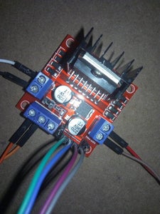

Step 2: Connects Motors to the L298n Dual H-Bridge Motor Driver
Connect motor 1 into output pin1,pin2 and motor 2 into output pin3,pin4 in the H-Bridge.
Connect motor 1 control pins (IN1,IN2) into digital pin5,pin4 and motor 2 control pins (IN3,IN4) into digital pin3,pin2 in the Arduino Uno board.
NOTE : remember to connect control pins into the output pins which can do pulse width modulation (PWM) marked with ~ (tilde mark)

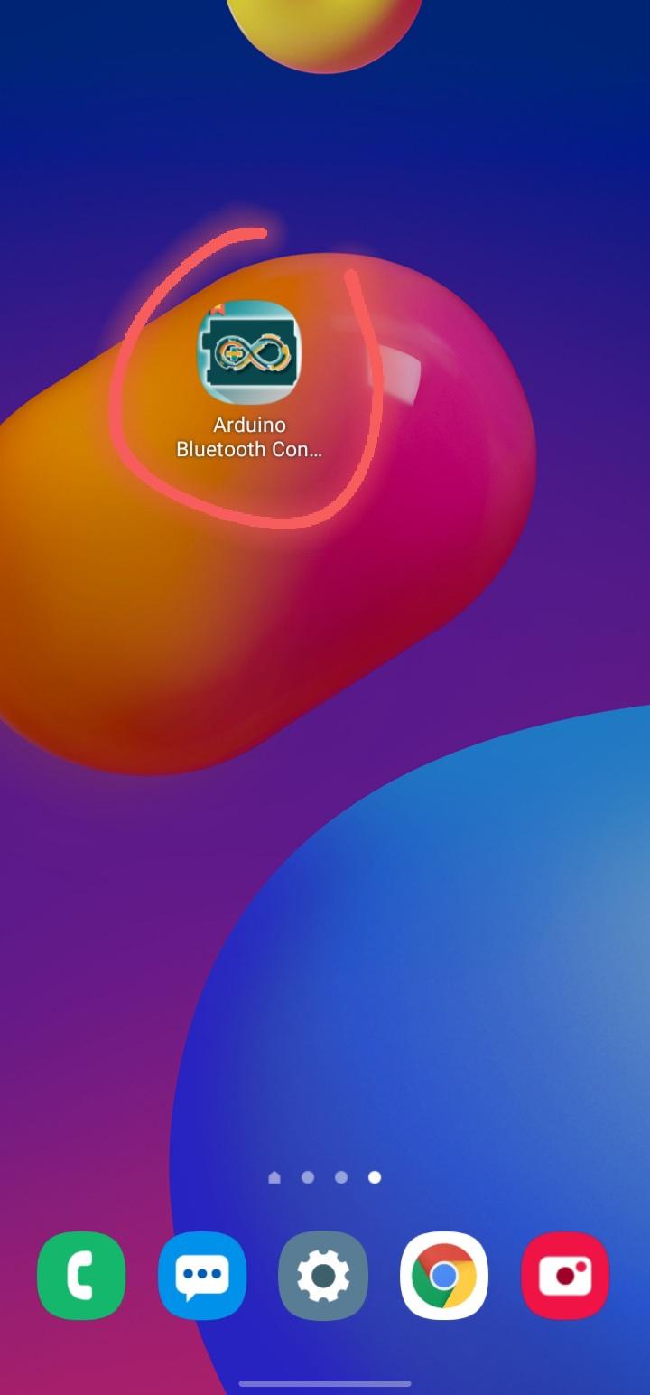

Step 6: Setting Up the Bluetooth Controller App

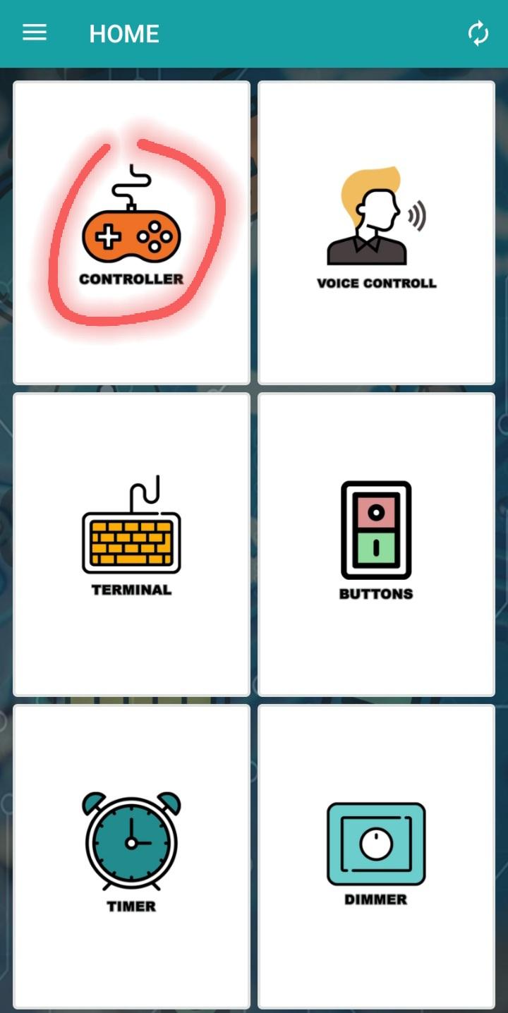

Here I'm using Arduino Bluetooth Controller - All in One but you can use any app according to your platform.

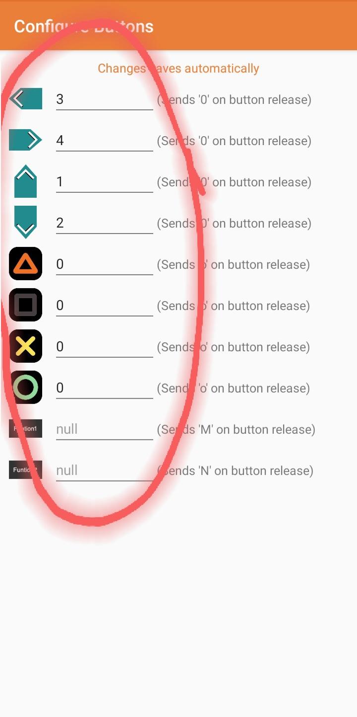

open the app>go to CONTROLLER > Configure Buttons> set the values for buttons (automatically save).
That's it all, now you can enjoy it :-)
