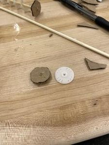

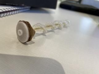

Using a hot glue gun create a spiral around the skewer to make the propellers. Gradually adding layers on top increases the size of the screws. You will need two as identical and symmetrical as possible to propel your boat. Once the screws are created, you need to attach them to the servo attachment. To do this first cut out 2 pieces of cardboard the same size as the circular servo attachment. Poke a hole through the cardboard circle with the skewer and attach it with hot glue. Then attach the servo piece to the propeller by hot gluing it to the piece of cardboard. Now you can attach and detach the propellers from the motor. Your propellers should look like the second example when finished. They are ready to be attached once we construct the boat!

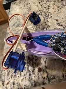

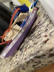

The next step is creating a small rest for the servo motors that will extend off of the boat. I used small pieces of leftover skewer to create a small platform for the servos to rest on, but you can also use cardboard or any other material you see fit as long as it isn't too heavy (you won't want to compromise the boat with too much weight). After using hot glue to attach the servos to the platforms, you will need to attach them to the side of your boat. I used a skewer that extended the width of the boat and was secured to the sides of the boat with hot glue, but depending on the height of the sides of your boat you may need more or less support. Make sure the propellers are angled into the water securing it with hot glue. My boat used 4, 1 inch skewer pieces for the vertical supports and 5, 1 inch skewer pieces for the horizontal supports and hot glue to secure them. Once placed on the boat I used tape to fasten the wires to the middle support.

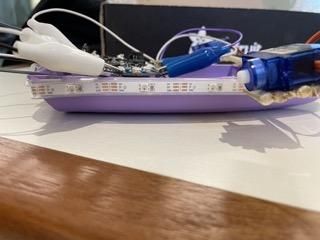

The LEDs should be modified (cut) or left alone based on user preferences. I choose to have my LEDs go around the outside rim of the boat and this required cutting the strip at about the half way point which resulted in 13 LEDs. I then used a glue gun to attach the LEDs to the side of the boat and made sure to start and end at the back of the boat so that there was enough space for the circuit playground to rest inside the boat.

The servos should have their Brown wire attached to GROUND, Red wire attached to 3.3V or VOUT, and the Orange wire connected to A2 or A3. The right servo will be wired to A2 while the left servo will be wired to A3

LEDs should follow the wiring Red to VOUT or 3.3v, White to A1, and Black to GROUND. I chose to solder these wires, but alternatively using a wire stripper and alligator clips should work fine as well, but this may add unwanted weight to the boat. If you decide to solder these LEDs on you will need copper wire and a soldering machine.
