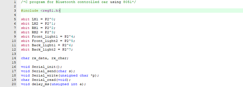

The first section is pretty straightforward. First, we would include the 8051 register configuration file containing all definitions and the addresses of the 8051 registers. Then, we would define Port 2 pins as Left motor, Right motor, and Front and back LED pins respectively. The variable char rx_data and rx_char are used to store data received from the HC-05 Bluetooth module. The prototypes of the different functions going to be used in the program are also given at the top.

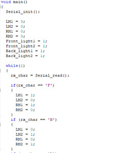

The main section of the program begins with initializing the Bluetooth Serial communication and setting the default states of different pins. Notice that LEDs states are set by default 1, the reason is that by virtue of the restraint output current of the 8051 chip, the LEDs’ negative terminals are connected with the chip. So, the LEDs would turn on by making the respective pins zero. Ultimately, they will receive maximum current and will glow at full brightness. Inside the while loop, the characters received by the microcontroller from HC-05 are copied into the rx_char variable, which is then checked one by one to perform respective operations. For instance, if the received character is ‘F’ then the microcontroller will make the Left motor and the right motor first pins high and the robocar will move forward.

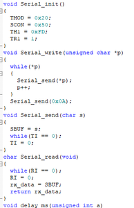

In the Serial_init function, the TMOD register is used to set mode 2 for timer 1 to generate a baud rate of 9600 bps. SCON register is used to set mode 2 for serial communication and also enabling the REN (Reception enable bit) to make Serial reception available. Timer 1 is then started to generate the baud rate.
The Serial_print function is used to send a string of characters to HC-05, Serial_send function sends characters to HC-05. Before sending the character through Serial lines, it is first stored in the Serial Buffer register(temporary storage for sent and received bytes). The buffer register stores the data which is then dispatched via Serial lines. After being dispatched, the TI flag of SCON is set, which is cleared afterward for future Transmission.
In a contrary case for the Serial_read function, after data is received from the module it is again temporarily stored in the Buffer register, while the RI flag is set. This data is then copied from the buffer register to the rx_data variable which is then utilized in the main function as described above.

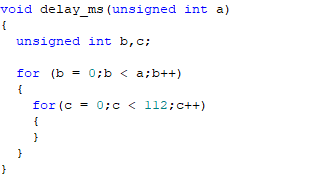

The delay_ms function is used to generate delay in milliseconds using the software instruction time rate method. For more information surf for software delay in the 8051 microcontroller.

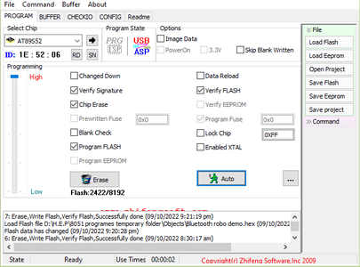

I have used Keil to write the C code for the project and also for the hex file. The hex file is burnt into the chip using progisp and usbasp programmer.

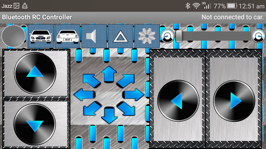

For controlling the car, I am using the Bluetooth RC car app on my android phone. You can download it from hereBluetooth RC Car - Apps on Google Play
