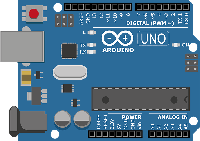

STEP1- take the chasis and past the ardunio ; l298n ; hc-05 and bo motor on the chasis. STEP2- connect all the bo motor to l298n
STEP3- connect l298n to arduino. As showen-
IN1 TO- pin 13D
IN2 TO- pin 12D
IN3 TO- pin 11D
IN4 TO- pin 10D
Connect power pin 5v to vin in arduino
STEP4- connect HC-05 to arduino as showen Vcc to –5v pin in arduino Gnd to – gnd pin in arduino Tx to-rx in arduino Rx to –tx pin in arduino
