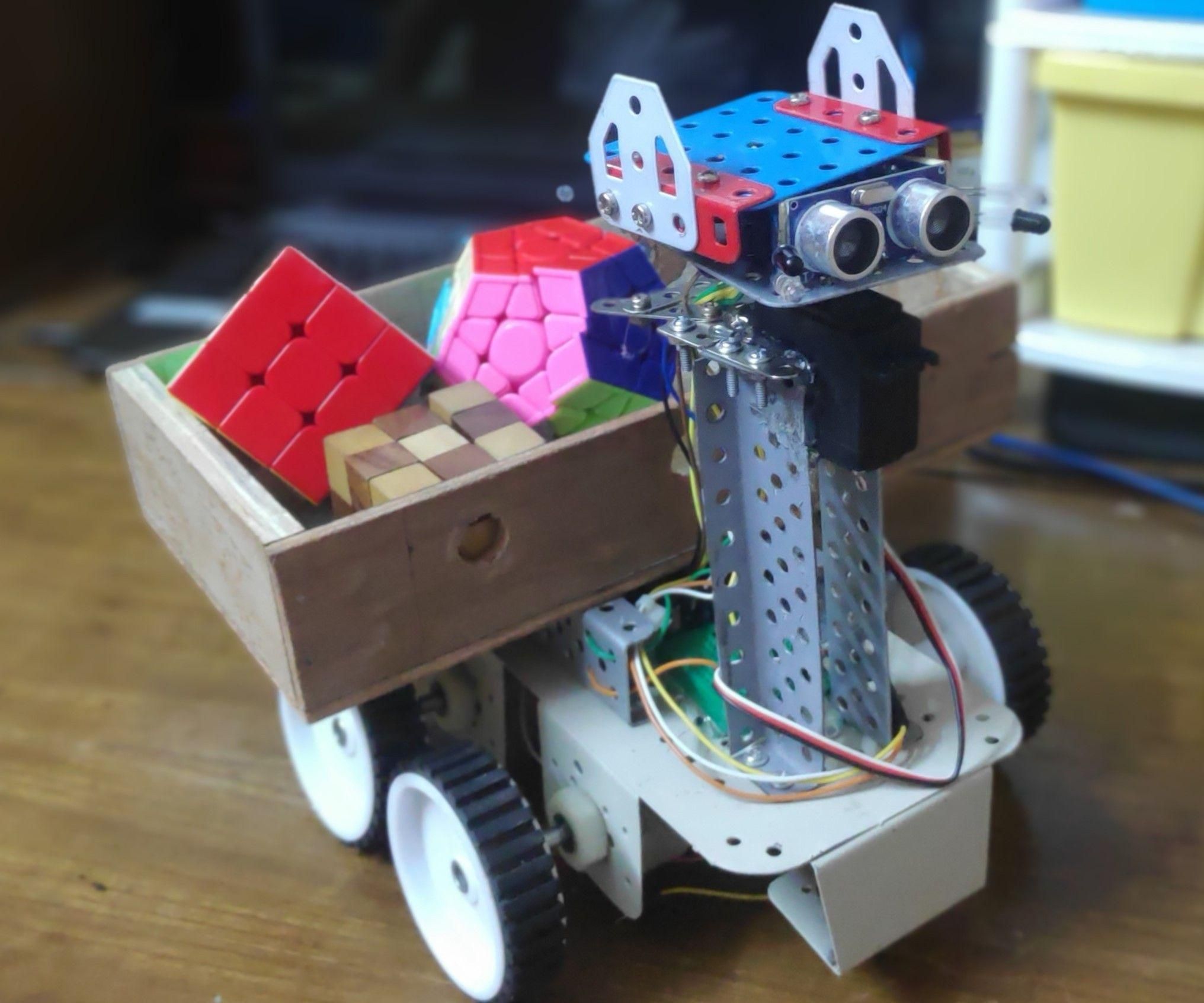

So as I didn't have the specific pre-built chassis for my motors so I had to build one myself. I chose the acrylic sheet for the base as it is lightweight and easy to work with and used standard clamps to mount the motors.
and at last screw the chaster wheel at the bottom to support the bot.
