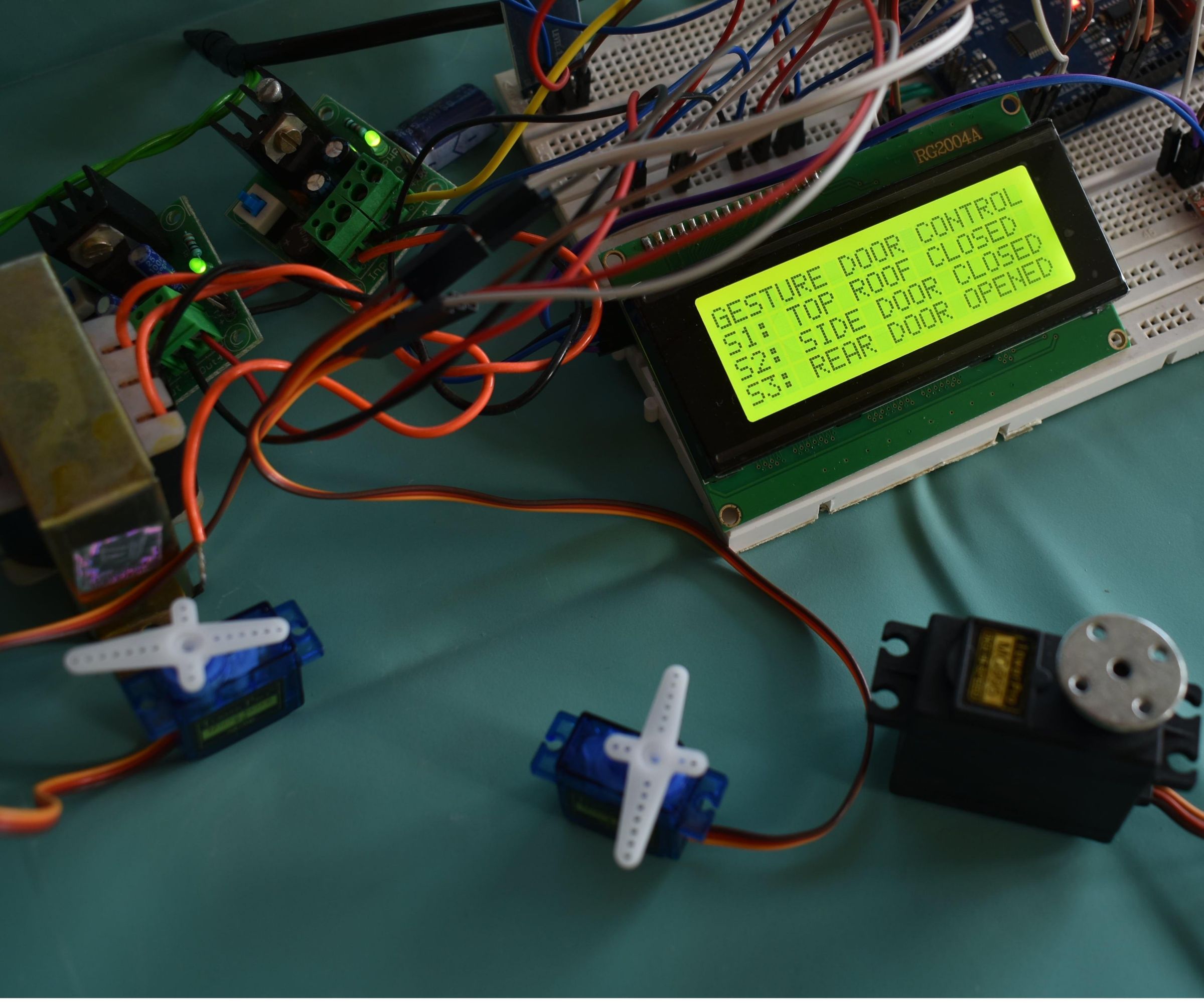

First, make the connections for the servo motors with the Arduino. Connect the black wire of both the servo motors with the GND of Arduino Connect the orange wire of both the motors to the 5V of Arduino Connect the Orange wire of the first motor to pin 9 of Arduino
